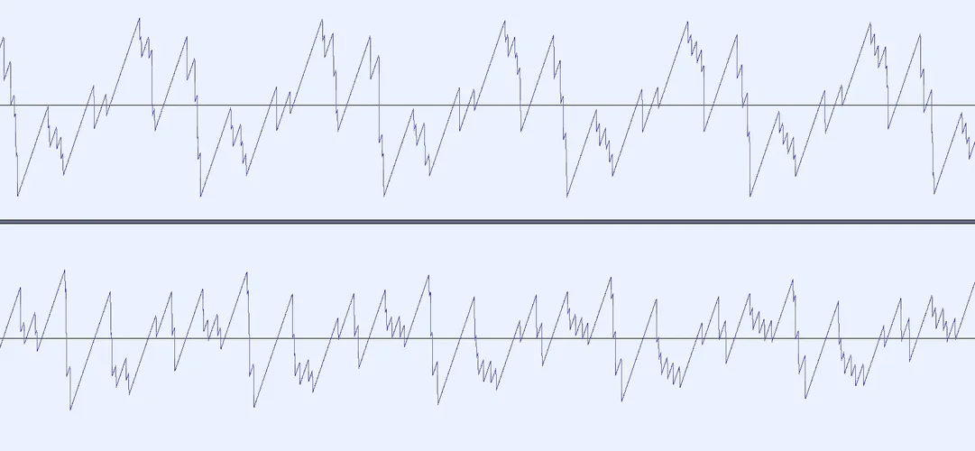

// Phase increment for SupperSaw
saw_inc32 += 1300000; (every 44.1KHz)
case WAVEFORM_SUPERSAW:
for (i=0; i < AUDIO_BLOCK_SAMPLES; i++) {
uint32_t ph_1 = phasedata[i];
uint32_t ph_2 = ph_1 + saw_inc32;
uint32_t ph_3 = ph_1 + (saw_inc32 << 1);
uint32_t ph_4 = ph_1 + (saw_inc32 << 2);
uint32_t ph_5 = ph_1 + (saw_inc32 << 3);
uint32_t ph_6 = ph_1 + (saw_inc32 << 4);
int16_t val_1 = signed_multiply_32x16t(magnitude >> 2, ph_1);
int16_t val_2 = signed_multiply_32x16t(magnitude >> 3, ph_2);
int16_t val_3 = signed_multiply_32x16t(magnitude >> 3, ph_3);
int16_t val_4 = signed_multiply_32x16t(magnitude >> 3, ph_4);
int16_t val_5 = signed_multiply_32x16t(magnitude >> 3, ph_5);
int16_t val_6 = signed_multiply_32x16t(magnitude >> 3, ph_6);
*bp++ = val_1 + val_2 + + val_3 + + val_4 + + val_5 + val_6; // result to Buffer
break;
while (index<DASCFG_IMPLEMENTED_WAVEFORM)
tunevalue_ch[index] = tunevalue_osc1;
if (channelnumber>0 && detunevalue_osc!=0)
tunevalue_ch[index] += ((channelnumber + (Max(1,(currenttick % primenumber[channelnumber-1])))) * detunevalue_osc) + (currenttick % primenumber[index+5]);
index++;
channelnumber++;
@Rolf: Deine Doppelplusse (doppelplus-gut??*bp++ = val_1 + val_2 + + val_3 + + val_4 + + val_5 + val_6;
) haben mich etwas ins Grübeln gebracht aber ich meine sie haben auf das Ergebnis keine ungewollten Auswirkungen.ist das der inkrement- und additions-Operator? Oder wären das 3 "+"?![]()
saw_inc32 += 6378593;
uint32_t ph_2 = ph_1 + (saw_inc32 * 1);
uint32_t ph_3 = ph_1 + (saw_inc32 * 2);
uint32_t ph_4 = ph_1 + (saw_inc32 * 3);
uint32_t ph_5 = ph_1 + (saw_inc32 * 4);
int16_t val_1 = signed_multiply_32x16t(magnitude * 0.40f, ph_1);
int16_t val_2 = signed_multiply_32x16t(magnitude * 0.15f, ph_2);
int16_t val_3 = signed_multiply_32x16t(magnitude * 0.15f, ph_3);
int16_t val_4 = signed_multiply_32x16t(magnitude * 0.15f, ph_4);
int16_t val_5 = signed_multiply_32x16t(magnitude * 0.15F, ph_5);
*bp++ = val_1 + val_2 + val_3 + val_4 + val_5;
break;
Versuch mal keine geradzahligen (schon gar nicht vielfache), sondern "krumme" Faktoren (1.31, 2.693 oder sowas....). In deinem Beispiel "treffen" sich die Wellen beim kleinsten gemeinsamen Vielfachen (bzw. Teiler) 12 und bilden dann die hörbaren Minima und Maxima.
.... es sei denn es ist so beabsichtigt (?)
saw_inc32 += 678593;
case WAVEFORM_BANDLIMIT_SQUARE:
for (i = 0 ; i < AUDIO_BLOCK_SAMPLES ; i++)
int32_t val = band_limit_waveform.generate_square (phasedata[i], i) ;
*bp++ = (int16_t) ((val * magnitude) >> 16);
break;
case WAVEFORM_SAWTOOTH:
*bp++ = signed_multiply_32x16t(magnitude, phasedata[i]);
break;
uint32_t spread_2 = saw_inc32;
uint32_t spread_3 = saw_inc32 + saw_inc32;
uint32_t spread_4 = saw_inc32 + saw_inc32 + saw_inc32;
uint32_t spread_5 = saw_inc32 + saw_inc32 + saw_inc32 + saw_inc32;
uint32_t ph_2 = (ph_1 + spread_2);
uint32_t ph_3 = (ph_1 + spread_3);
uint32_t ph_4 = (ph_1 + spread_4);
uint32_t ph_5 = (ph_1 + spread_5);
break;
saw_inc32 += inc >> 8;
uint32_t ph_2 = (ph_1 + spread_2) * 3.09f;
uint32_t ph_3 = (ph_1 + spread_3) * 5.01f;
uint32_t ph_4 = (ph_1 + spread_4) * 3.15f;
uint32_t ph_5 = (ph_1 + spread_5) * 4.79f;
break;
Nennt sich dann „Xmas Supersaw Massacre“?…
Aber trotzdem , was für ein dicker sound.... Ist auch bald Weihnachten. Mit dem Bass könnt ihr dann den Weihnachtsmann umhauen .
