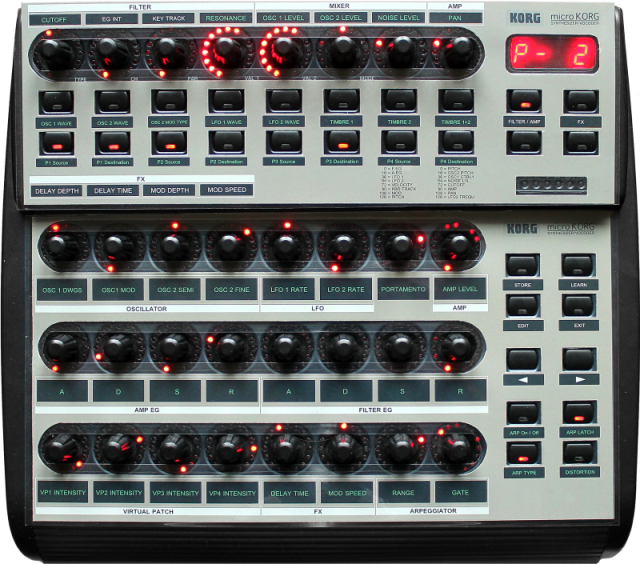

...Korg MicroKorg
http://anlage-e.de/custom-overlays-for-bcr/

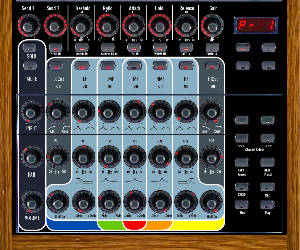

...Sonnox Suite Channel
http://recording.de/Community/Forum...hnik/Do-It-Yourself_(DIY)/148080/Thema_6.html

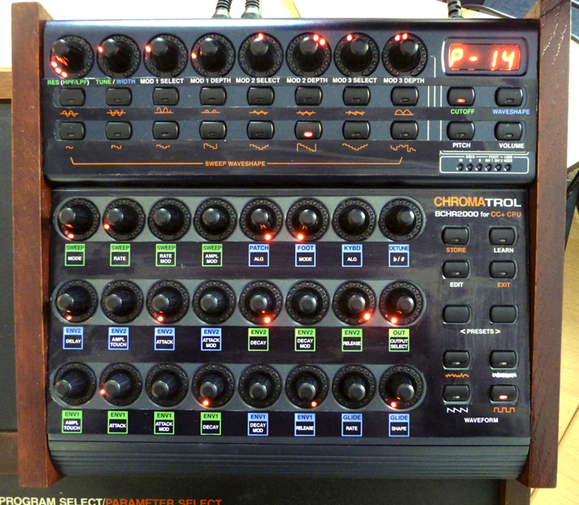

...Rhodes Chroma
http://www.rhodeschroma.com/?id=2010&month=01

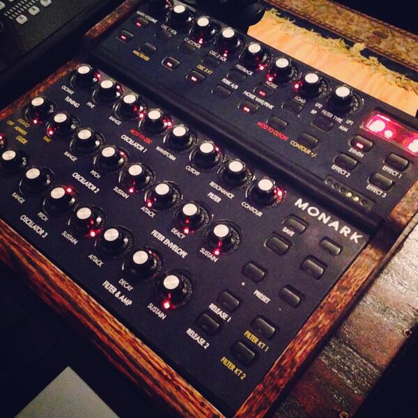

...NI Monark
https://twitter.com/deanalanswanson/status/465753932824723456
