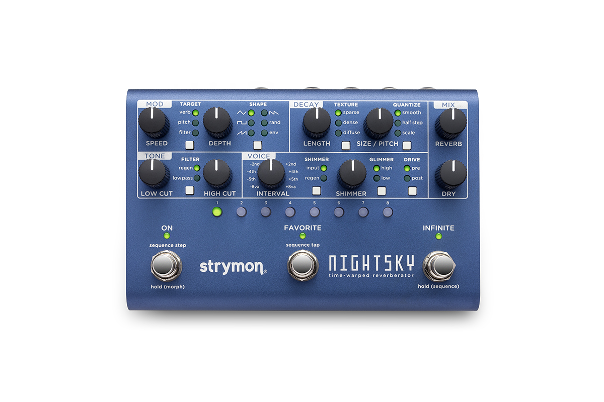

STRYMON NIGHTSKY REVERBERANT SYNTHESIS MACHINE
€ 489.00
ARRIVAL PRODUCT EXPECTED TO START OCTOBER
Reverberant Synthesis Machine
NightSky is a reverberant synthesis workstation and a powerful and manual experimental sound design platform. NightSky gives you continuous real-time control of reverb pitch / processing speed / size, harmonics, and even a resonant synthesizer-like filter with multiple modulation waveforms, as well as a step sequencer with variable scrolling. You have never heard a pedal like this before.
Time-Warped Reverberator
Create stunning soundscapes by playing just a few notes of your instrument. Apply a pitch effect and harmonic manipulation to the reverb tail, with sweep filters similar to those of a synth. Enter a world of new sounds that sweep the boundaries of what was possible with reverb. With the pioneers and adventurous sonic explorers in mind, we’ve created a reverb pedal that can go where no one has gone before!
New Sonic Territory
NightSky is an irresistible reverb pedal. Deep, powerful sound manipulation with instant control response, and the absence of gibberish menus, set a new standard in experimental reverb design.
Warp Core Reverb
NightSky achieves some of its most mind-blowing sounds by using a variable process speed for the reverb core, allowing you to simultaneously change its size and pitch. This reverb pitch change can be completely smooth or quantized on a variety of musical scales. And it can be sequenced!
Harmonic Sculpture Machine
Use the Shimmer effect to change the harmonic structure via selectable musical intervals. Add the Glimmer effect to dynamically enhance the harmonic spectrum. Increase the Drive controll to generate overdriven saturated harmonics. Then sculpt the resulting signal with the synthesizer-like variable resonance low pass filter.
Sound Design
• Three selectable reverb types offer a wide variety of ambient textures: Sparse, Dense, Diffuse.
• Sparse: Creates reflections far enough away from each other so that they are clearly distinct. Linked notes create an exuberant but pleasantly clean sound field, while staccato notes reveal individual echoes that are well suited to sound design and special effects.
• Dense: is an immediate response reverb with a uniform sound texture, with characteristics similar to plate-type reverbs.
• Diffuse: Creates slow-building atmospheres that excel with ambient textures, swells and even reverse. Diffuse reverb deconstructs and spreads transients over time to achieve its expansion effect.
• MOD section with six different waveforms to modulate the reverb or tone filters
• TONE section for sculpting the equalization of the highs and lows of the reverb
• VOICE section to improve the sound spectrum of the reverb
• Adjustable SHIMMER effect to add pitch shifting up to +/- 1 octave to the reverb
• The GLIMMER control dynamically enhances the high or low frequency harmonics for synth-like textures
• DRIVE Pre or Post control to add saturated harmonics to the reverb
• Adjustable reverb room size to increase or decrease the space for reflections
• Independent REVERB effect and DRY sound level controls
• Step sequencer to program rhythmic variations of the reverb pitch
• Access to 16 favorite presets from the front panel, 300 presets via MIDI

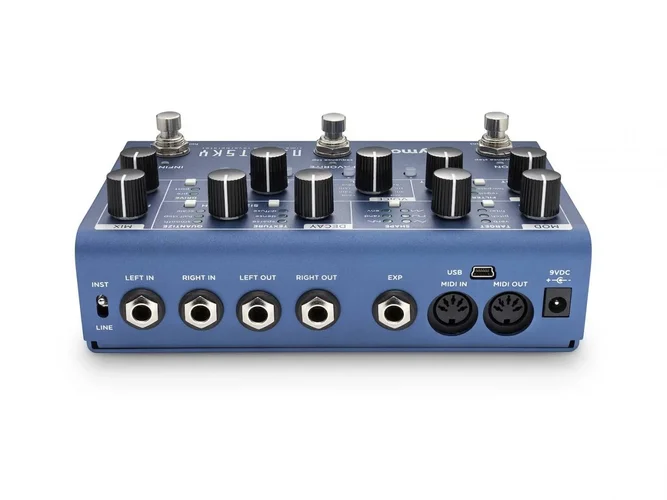

Ins, Outs, Switches
• Class A high impedance stereo input
• Low impedance stereo outputs

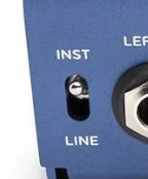

• Input switch for instrument / line level selection
• Footswitch for effect on / off control, favorite preset and Infinite function
• EXP input for connecting an expression pedal, the MultiSwitch Plus, or the 1/4 ”jack / MIDI cable • Complete MIDI In / Out implementation with MIDI CC support, program changes, etc.
• USB port for MIDI control via computer, and for firmware updates

Klingt schon ziemlich cool für Ambient. Mit dem Modulationssequenzer scheint aber noch keiner wirklich was anfangen zu können...
Ich habe Nightsky jetzt hier
Vorweg es klingt wirklich sehr sehr gut ...Funktionsumfang bekannt und wirklich klasse .... Verarbeitung 1A, Strymon halt
ich habe dieser hinsicht auch nix anderes erwartet.
Allerdings....
Der Sequencer ist nett gemeint .... aber der hat noch jede menge Potential.
Ist halt bis jetzt nur auf Size/Pitch anwendbar, sehr langsame clock einstellen geht leider auch nicht max 2000ms per step und beim ein Tappen des taktes geht er nach 2000ms zum nächsten step ob ich das will oder nicht.
Midi Clock ist bis jetzt nicht teilbar also dauerhaft die eingehende Clock auf den Sequencer.
Sofern ich da nicht was übersehen habe, finde ich das sehr schade und ehrlich gesagt etwas schwach.
Wenn man im "normalen" Green Modus ist und auf eine der 8 step tasten drückt aktiviert er sofort den Favorit, ist hoffenlich ein Bug. ansonsten mega nervig kommst dran schwups irgendein preset ausgewählt.
Die LEDs nerven mich auch etwas im Grün scheint immer mal ein Rot mit durch, mehr son effekt.
Das wars erstmal mitn gemecker ;-)
Ich habe zwar schon den BigSky von Strymon und es stellt sich mir gerade die Frage, ob der NightSky eine gute Ergänzung dazu wäre.
Ich habe neben dem Nightsky noch das Space von Eventide & das FX Aid Modul (wo ich hauptsächlich die Reverbs von benutze) Finde das Nightsky eine schöne Ergänzung dazu. Auch schön erst ins Volante von da ins Nightsky ... abgefahren :)
Was die Haptik angeht: Shift Funktionen ohne Beschriftung. Zu kleine Taster. Kryptische Finger-Kombos an den Step-Tastern. Alles nicht so super.
Man hätte das Pedal gerne 50% breiter machen und die shift Funktionen damit ins UI aufnehmen können...
