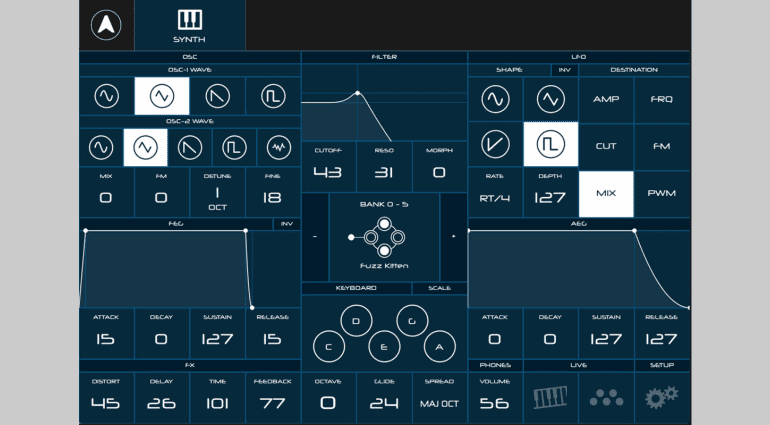

Powered by USB or 3 x AA batteries
Optional software editor available for macOS, Windows, iOS and Android
