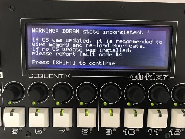

  • #585
1.)
http://files.sequentix.com/cirkos-revision-history-from-v1.08.txt
*** ALWAYS BACKUP YOUR DATA BEFORE UPDATING THE OS ***
Use the "SAVE Raw SYX dump" option to ensure all data and configuration
settings can be restored
2.)
http://wiki.sequentix.com//index.php?title=Notes_on_updating_the_OS#memory_wipe_out
memory wipe out
To wipe the memory, keep the SONG key held as you power on, then press the encoders 6 & 8 together to confirm when the wipe memory page appears. Then restore from your normal backup.
data loss
When updating the OS, you should always make a backup of your song data. In most cases, the data will survive the update process, but sometimes changes to the internal data format may require the data to be reloaded.
After an OS update, you may see the warning message:
WARNING: bbram state inconsistent
press <SHIFT>
The most common reason for this message to appear is because new configuration values have been added to the battery-backed memory area.
The warning message will be followed by a prompt to Wipe ALL Data
You do not normally need to wipe and restore your data after an OS update.
Just press 'cancel' and continue as normal.
However, under some circumstances (eg. major changes in the internal memory structures) it may be required to delete to old data: just wipe it out and reload the data from backup you`ve done before (see full dump memory backup below).
If there is any problem with the data, there is a further check of the data that should detect it.
M.i.a.u.: youkon
  • #586
Problem gelöst oder Blue Screen beim Cirklon?
  • #587
Bin grad leider wieder unterwegs!
Allerdings lief er nach der Fehlermeldung wieder ( habe nichts gelöscht )!
Jedoch hat die Gang-Taste keine Funktion mehr!
  • #588
D. h. du hast reboot ohne "Wipe ALL Data" und nun geht die Gang Taste nicht mehr?
Ein Backup deiner config/persönlichen_Daten(Songs) erstellen. Einfach alles mit: "SAVE Raw SYX dump".
Dann ein "Wipe ALL Data", kann das z.B Gang Problem gelöst werden.
Dann wieder "Load Raw SYX dump".
  • #589
