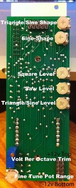

Ich fang mal an, bei dem Pittsburgh Oscillator sieht es so aus....
Setup and Calibration
The back of the Oscillator module has an expansion header and several trimpots that can be used to calibrate and adjust the Oscillator.
From top to bottom:
10 pin Expansion Connector
Triangle/Sine Shape - Used to align the rising and falling slopes of the triangle wave.
Sine Shape - Used to modify the shape the sine wave. The trimpot has a shape range of triangle wave to square wave shape with the sine being close to the middle.
Square Level - Output level of the square wave
Saw Level - Output level of the saw wave.
Triangle/Sine Level - Output level of the triangle and sine waves.
Volt Per Octave Trim - 23 turn precision trimmer used to set the 1 volt per octave tracking of the Oscillator. If the Oscillator is undertracking, adjust the trimmer to the left. If the Oscillator is over tracking, adjust the trimmer to the right.
Fine Tune Pot Range - Adjusts the range of the fine tune knob.
Power Connector - +12v is at the top of the connector and -12v is at the bottom of the connector.
Ein Foto/Video, von einen konkreten Kalibrierungsaufbau würde mich ebenfalls interessieren.
