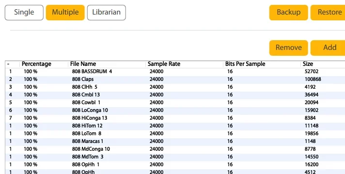

Kann die LMdrum auch 16bit Samples laden?
Jein. Man kann auch 24 bit Samples in Synthtribe laden, diese werden aber zu 16bit/24kHz konvertiert. Playback in der LmDrum ist aber immer maximal 12 bit.
Aus dem Manual:
USING SYNTHTRIBE
Any .wav file under 1 Mb in size, can be loaded into SynthTribe and downloaded onto the LM DRUM. SynthTribe will convert stereo samples to mono and adjust the sample rate to 24 kHz. The LM DRUM’s native format is 12 bit, 24 kHz mono. The files can be sent singly, or as a multiple send, will download into the first empty slot(s) of the currently selected bank. SynthTribe also includes a Librarian function which allows samples to be backed up and restored individually.
The total storage available for user samples, whether made direct to the LM DRUM or downloaded from SynthTribe is 14.17 Mb; which equates to 310 seconds (5.16 minutes) of sample time.

Egal: Hier mal ein paar 808 Samples aus der LmDrum, einfach nur per synthtribe geladen statt gesampelt. Sehr nett finde ich den Bass-Schub, wenn ich später um 10 sek das HP Filter mit Resonanz einschalte.

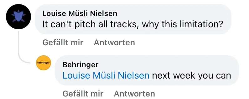

This journey began over four years ago, shaped by your input, and we truly appreciate your support. A special thanks to Roger Linn for his recent suggestion to make all instruments tunable. Our engineers have already implemented it and are testing the feature, with a software update planned for next week.
