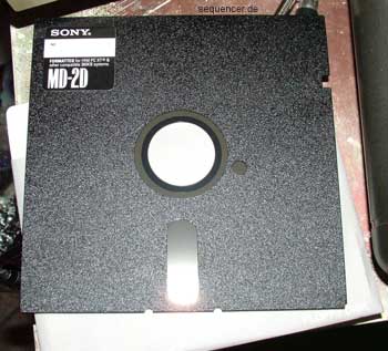

  • floppy discs (exept 3.5" which isn't "floppy") can be used bo oth sides, but be careful on this.
  • 3.5" got a write protect "switch", while the big ones had stickers, the image shows no sticker (right upper side), so it isn't write protected, and this one is formatted one sided since there is no second write protection hole on the left side but possible.
