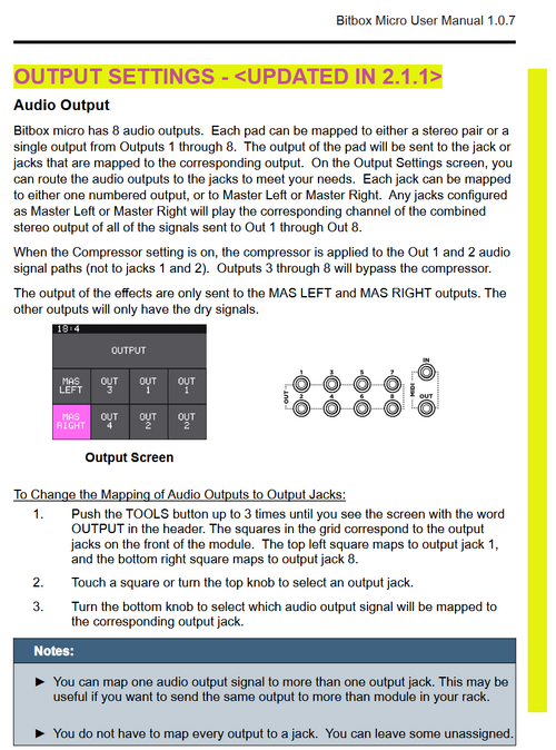

Es gibt ein neues Update für die bitbox micro
Bitbox Micro 2.1.0
Today, 01:45 AM
We're finally getting our version numbers in sync between bitbox micro, MK2, and blackbox.
Here is a recap of new features, first made available in version 1.2:
  • LFO per voice with the option for beat sync. This applies to sample, clip, granular, and slicer modes
  • Modulation of the envelope Attack, Decay, and Release, including control via MIDI CC
  • Resonance control on the filter, including the ability to modulate it
  • Enhanced Delay algorithm with integrated band-pass filter and the ability to play just a single echo
  • More advanced granular controls, including density, scatter, and pan spread
  • MIDI based recording of cells. Be sure to switch MIDI Rec to ON in the TOOLS/Rec page.
  • New SD Mode to enable the hardware to work with more micro SD cards
Here are some of the bug fixes that are new in version 2.1.0:
  • The FX1 and FX2 returns are present in Out 1 and Out 2. (FX returns are now only in MAS L and MAS R)
  • Clips have improper polyphony options
  • Sometimes loading a mutlisample will leave incorrect pitch mapping between sampled notes.
