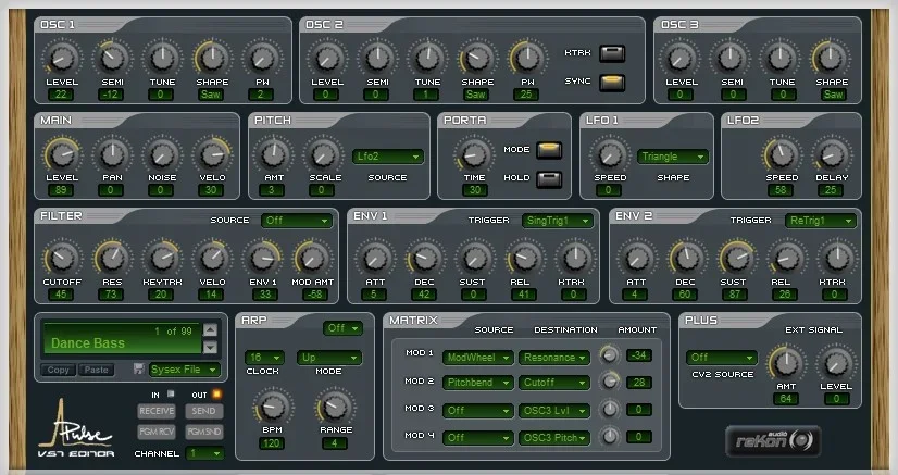

Btw. this is what rekon audio came up with for their Vst-Editor for Pulse. Maybe you can use this as a starting point. Actually I would prefer seeing all 4 modulation source and target possibilities separately, meaning layed out fully in 2D space, not integrated in a pulldown menue, as I find them quite important. But let's wait and see, later we can still create new GUI variations...atomix1040 schrieb:The pulse editor is almost ready, i will post some changes today on theh project site.
