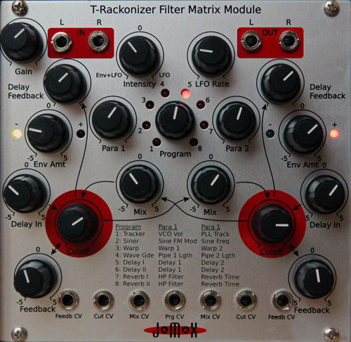

Jomox News- T-Rackonizer Filter Matrix Modul
Eurorack complex time-woven filter matrix.
The T-Rackonizer transforms timely events into an analog feedbacked filter network.
The T-Rackonizer is the eurorack successor of our very sucessful T-Resonator which did very well over the past 7 years. It has been the least possible implementation of the former experimental filter network synthesizer called „Resonator Neuronium". The number of 6 nodes had been reduced to only two filter nodes - but still this structure offers a tremendous variety of sounds.
The module contains 2 analog T-ladder moog-like filters and a digital delay.
Not only can these two filters being controlled by cutoff and resonance - they can be feedbacked negatively or positively to itself or even across the partner filter by the mix knobs. Also they can be feedbacked across a digital delay/reverb chip which is literally woven into the signal path.
On the T-Rackonizer, the feedback and cutoff controls can be CV-controlled. Once you insert a CV cable into the CV jacks, the corresponding internal control knob (e. g. Cutoff) acts as an amount to the external CV. Without CV input, the control knobs work across the internal range.
The filters are made from discreete parts and form a 24 dB pole lowpass filter transistor cascade.
You can select 8 different algorithms, each with different delays, wave guides or structures and different feedbacks and modulate them even with an LFO.
Delays reach from less than a millisecond to 1 second, range and structure is depending on the algorithm.
These capabilities let you create evolving analog tape echoes, "klingon parties" by extremely feedbacked wave guide algorithm and much more.
By the analog feedback everything sounds organic.
The screaming analog feedbacks can delay themselves and thereby form new sound patterns.
The sine LFO gets retriggered by the audio signal and can be shaped with the audio envelope or just run alone.
In center position the amount is 0, to the left it's envelope-shaped LFO, to the right it's only LFO.
Incredible bass gains or screaming scratch sounds are no problem. Positive feedbacks create distorting bass enhancements or low feedback tones without applying a signal.
The mix pots are zeroed in center position; any other angle will couple or feedback negatively or positively.
The external CV inputs work from 0 to 5 volts. At maximum amount (corresponding control knob open fully clockwise), a voltage of 2.5 volts represents the center position of the control. This is very useful for usage with most of the external CV sequencers available.
The input has an adjustable gain and a Hi-Z input to plug in a guitar directly. Any line level signal can be processed, be it either mono or stereo.
The T-Rackonizer will be availabe in May 2015.

Das ist das dümmste was ein designer seinem Modul antun kann !
.......und es setzt sich immer mehr durch wie mir scheint.
dann hat der Jürgen es auch nocht mit der positionierung der CV buchsen vergeigt.........
wäre nicht nötig gwesen die 4 ( von 6) Buchsen direkt unter die potis zu kleben.........
Stimmt, Design ist nicht so dolle. Auch wenn das Foto nicht die Endversion ist denn die hat wohl bei den In/Out´s noch son Schutzring drauf/dran, dass die nicht so lose aussehen. Also testen sollte man den auf jedenfall, dafür gibt es wohl genug Gründe.
Das wird doch bestimmt so nicht auf den Markt kommen? Einige Knöpfe sind voll dicht am Rand, wenn daneben auch ein Modul wäre wo auch ein Knopf genau gegenüber genauso weit am Rand wäre, dann würde sich jener Knopf ja immer in umgekehrter Richtung mit drehen :lollo:
Scheiße das stimmt sogar, ich dachte das Bild wäre beschnitten. Natoll nun isses behindert.
