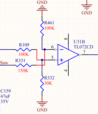

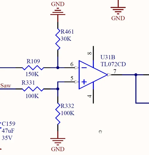

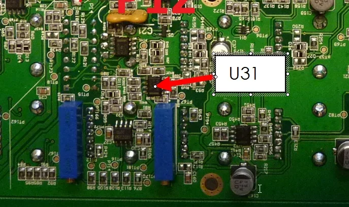

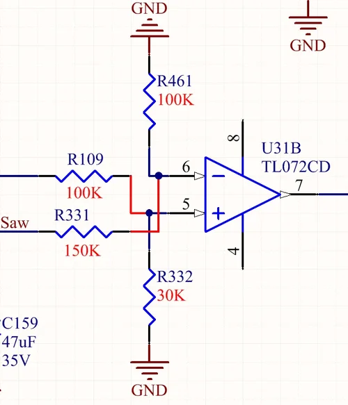

auch ganz interessant diese anleitung zum beheben eines phasenproblems der rechteckwelle aus diesem fred im arturia-forum
jpmartineau schrieb:
There seems (I hope I'm wrong) to be a design issue with the square wave generator in relation to the sawtooth wave generator. Sorry if this is a bit technical, I'd really appreciate input from the engineers on this one.
I've noticed that when the Saw is all the way up and I bring up the square wave (at 50% duty cycle), eventually, when both are up, I don't hear the square wave anymore.
I haven't checked with a scope, but what I'm suspecting is the following:
When adding both waves, if at phase 0º the saw is starting from -1 and ramping up to +1 at 360º and the square starts at 1 until 180º where it will go to -1 until 360º, then, instead of the expect addition of harmonics, the result is a sawtooth wave that is phase-shifted by 180º. That phase shifted sawtooth wave sounds exactly like the sawtooth alone.
What should be done is the square wave's phase should be inverted so that from 0º to 180º, the value is -1 and 1 from 180º to 360º.
Bruno@arturia schrieb:
Do you have a microphone in my office? ;)
that's exactly what happened, we had to change the design, forgot about the square phase, but when we noticed we decided to keep as is, because, despite it surprising to have the square disappear, it indeed nice to get the octave up saw, and the out of phase saw that gives a different result when mixed with a triangle.
anyway that the way the machine is. and that probably why some people are saying the oscillator could sound weak.(...)
A hardware fix would require to swap two SMD 0805 resistors, remove two others, and replace them with through hole, soldered on smd pads.
So doable if you are used, and tooled for SMD.
schaltung vorher:
schaltung nachher:
da gehts lang:
hat das hier schon wer probiert? mir persoenlich viel zu fummelig, und scheint mir auch weniger dringlich als der huellkurven-fix, aber das resultat taet mich schon mal interessieren. :)

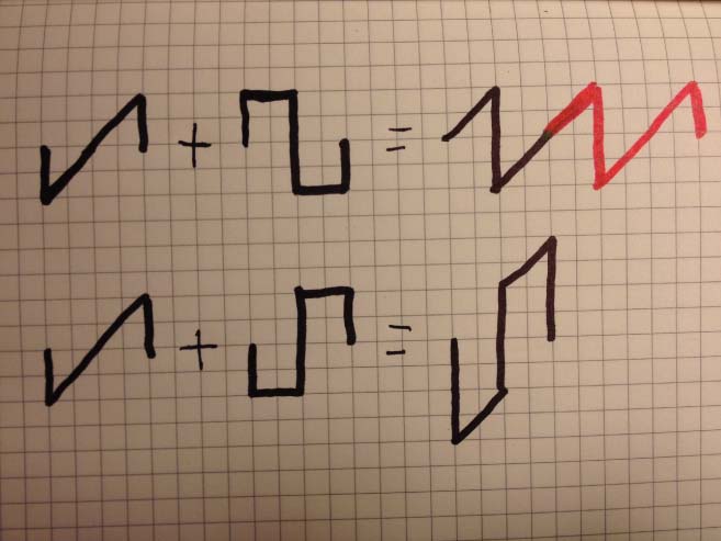

[ http://i.imgur.com/m0Z33.jpg (•BILDLINK) ]
Is das wirklich so krass? ich meine hörbar? Wenn ja, ist das ja wirklcih ein sclimmer Schnitzer.. Wenn ich 2 Wellenformen mische sollte schon das Richtige bei rauskommen..
Mist, und ich überlege mir anstatt eines 2ten microBrute nen Minibrute zu holen.
1) Es gibt hier kein Falsch oder Richtig, hier wurde durch einen "Happy Accident" eine Entscheidung getroffen, die andere interessante Ergebnisse liefert. So aufregend ist die phasengleiche Mischung Square und Saw jetzt auch nicht. Eher noch Triangle + Saw, aber da passt die Phase ja ohnehin. Insofern finde ich die Upper-Saw sehr gelungen, vor allem wenn man sich mit dem Fader um den Sweetspot herum bewegt
2) Der MicroBrute verhält sich 100% genau so.
3) Runter mit dem Pegel bei den Schwingungsformen! Am besten unter 50% bleiben und einfach Volume lauter drehen. Gerade beim Mischen von Schwingungsformen macht das einen grossen Unterschied.
