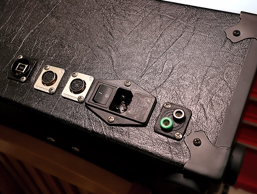

Hi,
I recently put together a small portable system in a Synthesizers.com QCP22 case and I had a custom power solution using two small power-one / Bel power linear supplies, one for + -15v & + 5v and another for + -12v.
