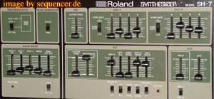

Roland SH-7 sh7 synthesizer
Roland SH-7
Roland SH-7 sh7 synthesizer IMAGE

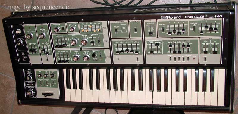

sh7

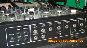

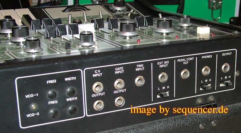

cv ins + outs

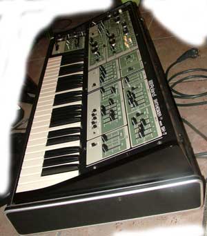

sh7 sh7 synthesizer
sh7

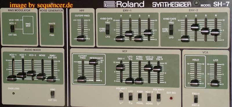

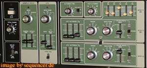

it has 2 complete ADSR envelopes, VCO or noise can mod the 24dB/oct. LPF filter. it has no BPF like the SH-5 but it's filter has 24 instead of 12dB/oct like the sh5 has. but it is not a multimode filter!.. the sh7 has 2 VCOs with hard sync (soft sync got lost over thos 3 years between the 1975 made sh5 and the sh-7 (1978). it was the latest model ,even after the system 100 which was the "most modular" one of the sh series (in fact the system 100 is a member of the sh-series family dynasty ;). back to the sh7: it's VCO1 has 5 Slides to control 32',16',8',4' and 2' Square Waves (quite sh-3a like..) , hardsync with autobend, sort of a mini envelope with time adjustment ("decay"). each VCO can be modulated by s/h, autobend or the LFO. yes! it's one LFO (20hz max still as the sh5, but the sh5 has 2 of them) the sample and hold is cool, like the whole sh series and sys100 it has some waves and random input, sample time and lag! so it is what s/h should be! complete! comparable to that of the arp2600..
the LFO sine wave can be fade in and the lfo can be triggered by Keyboard.
like the sh5 both VCOs offer tri,sq, saw and pw (manually and modulated by lfo or env1)
only vco2 has a fine tune as an offset to vco1. of course both VCOs have still their octave switch.

there's a noise generator with white and pink noise available ,too..
all can be mixed separately: vco1,2,the "drawbaw of vco1 section",ringmod, noise / ext (alternatively)
VCa can be modded by one of the envs..
