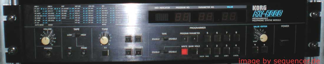

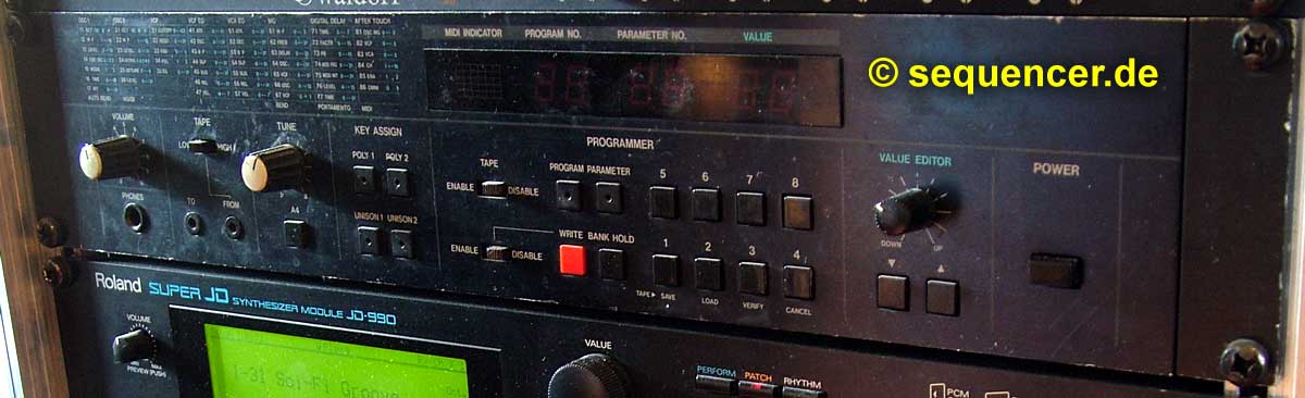

Korg EX8000
rack version of the dw-8000
Korg EX-8000 Korg EX8000 synthesizer
Korg EX-8000
rackversion des DW8000
Korg EX-8000 Korg EX8000 synthesizer IMAGE
Korg EX8000
DW-8000 Rack
Korg EX-8000
