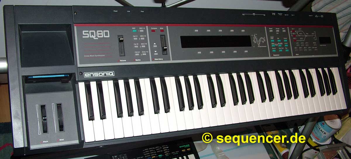

SPECS
Ensoniq SQ80 synthesizer
pic shows SQ80
other ENSONIQ gear..
Built 1988
Type: digital
Hybrid: yes
8 Voice / Stimmen
8x Multitimbral
standard Memory / Speicher
Value / Wert in 2017 ca. 270 (-)
Synthesis: subtractive
OSC Features 8bit sample sync AM ringmod
Wave Shapes 75 digital
3 OSCs
1 Filter lpf reso 4 Pole
3 LFOs triangle saw square random
4 Envelope Generators 4x 6stage
MIDI Control / Triggering
61 Keys with pressure velocity deluxe
Arpeggiator no
Sequencer real time sequencer
(ID 241)

VERSION ESQ-1: Keyboard, ESQ-M: Rack - SQ80: more waveforms and polyphonic aftertouch and disc drive.
VERSION ESQ-1: Keyboard, ESQ-M: Rack - SQ80: mehr wellenformen und polyphoner Aftertouch, Diskettenlaufwerk.
VERSION

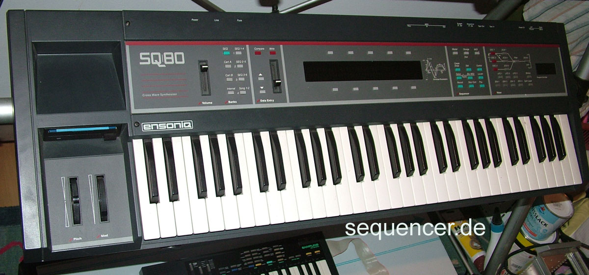

THE ENSONIQ HYBRID SYNTHESIZERS
ESQ1 - ESQ-M (rack) are the predecessors of the SQ80, the difference between them is simple:
1) the poly pressure keyboard (the esq has no AT at all)
2) more waveforms (some digital gritty stuff)
3) some small changes to the ENV section (if an R is displayed the SQ80 simulates some sort of "reverb",, well funny these days, huh?)
ensoniq sq80 synthesizer
both are 3 OSCed ROM waves with 8bit , anyway it can sound real nice and soft, it has 3 LFOs and 4 ENVs, and sync and AM for "dirtier" sounds. the concept is much of the xpander , the usier interface is a big display and softknobs around it.. just hit the section (eg. filter) and then the parameter name and move the data slider..
the VCF is an analog 24dB/LPF
all OSCs can be modulated because they all have their own VCA!!
