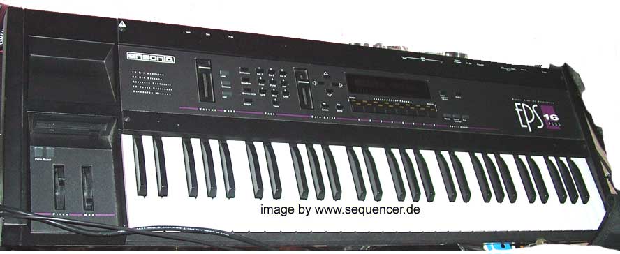

Ensoniq ASR10, EPS16+ synthesizer
pic shows EPS16+

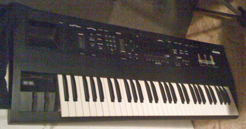

ASR-10 Keyboard
ASR-10 Tastenversion ASR-10 Keyboard synthesizer
ASR-10 Tastenversion ASR-10 Keyboard synthesizer IMAGE

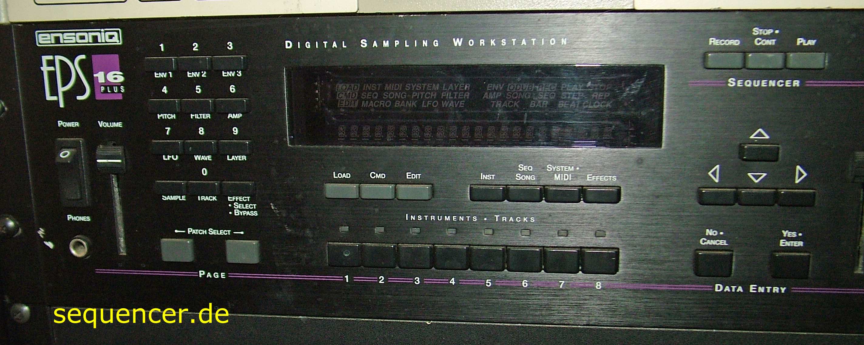

Ensoniq EPS16+ Rack
Rack Version with SCSI & Individual Outputs
Ensoniq EPS16+ Rack Ensoniq EPS16+ Rack synthesizer
by: Rex Athey (link)
Ensoniq EPS16+ Rack
Rack Version mit SCSI & Einzelausgängen
Ensoniq EPS16+ Rack Ensoniq EPS16+ Rack synthesizer IMAGE
