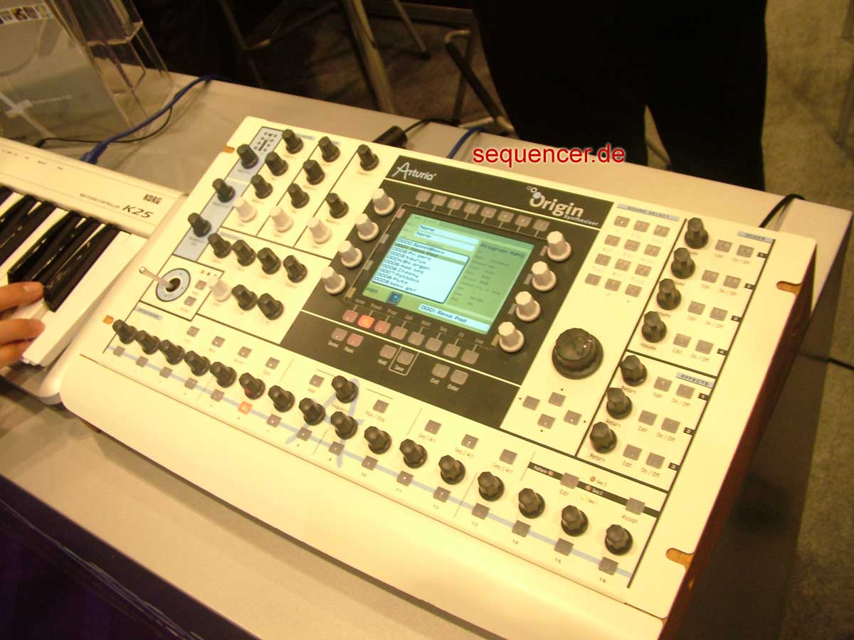

Arturia Origin Desktop
the desktop Origin
Arturia Origin Desktop Arturia Origin Desktop synthesizer
Die Desktop Version vom Origin
Arturia Origin Desktop Arturia Origin Desktop synthesizer IMAGE

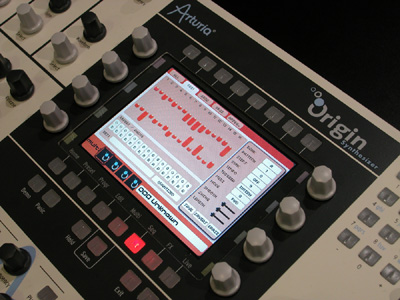

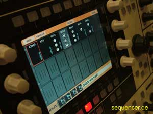

Arturia Origin
Knob + Display..
Arturia Origin Arturia Origin synthesizer
Arturia Origin
Display
Arturia Origin Arturia Origin synthesizer IMAGE

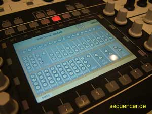

Arturia Origin
Knob + Display..
Arturia Origin
Display: Modular Moog V
