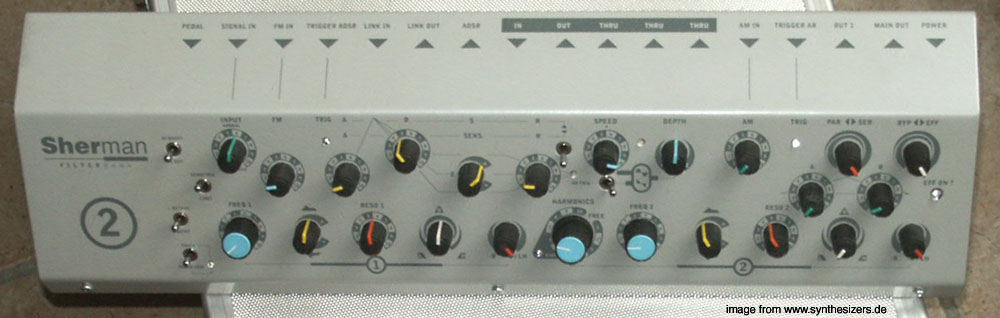

basically the Sherman Filterbank 2 is a synthesizer without oscillators!
maybe a nice DIY project could make this machine a real charsimatic synthesizer?
maybe add a nice small mfb synth to drive it.. ;)
btw: I have never seen such a good manual with so many examples and really easy!
and: hmm, cute! really.. as cute as the "VCA-man" in the ms20 manual
sherman filterbank
enlarge above image? click the image..!!
FM and AM! "distortion" by overdriving the input!
filter sounds quite rough "british" ms20'ish!.. but it never sounds "bad". but it CAN SOUND EVIL! ;)
you have 2 independet filters both sweepable from LPF to BPF to HPF! also there is a nice knob for adjusting the filters called anti mix correction.
here you can have non symmetric bpfs ,lpfs and hpfs.. so this makes another "kind" of filter characteristics.. (eg: a hpf that still lets some bass freq. pass through)..

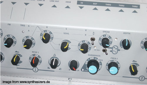

see the harmonics knob? here you can set the second filter to be a static harmonics "generator" for you! this make a lot of sense for drumloops and stuff..
ADSR env and an LFO that max range is audio speed! the lfo has some triangular waves
I tested it with a fairly "non phat"-drumloop.. if you set it right, you can beef it up a lot!!!
