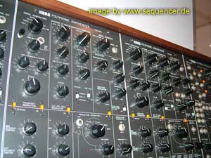

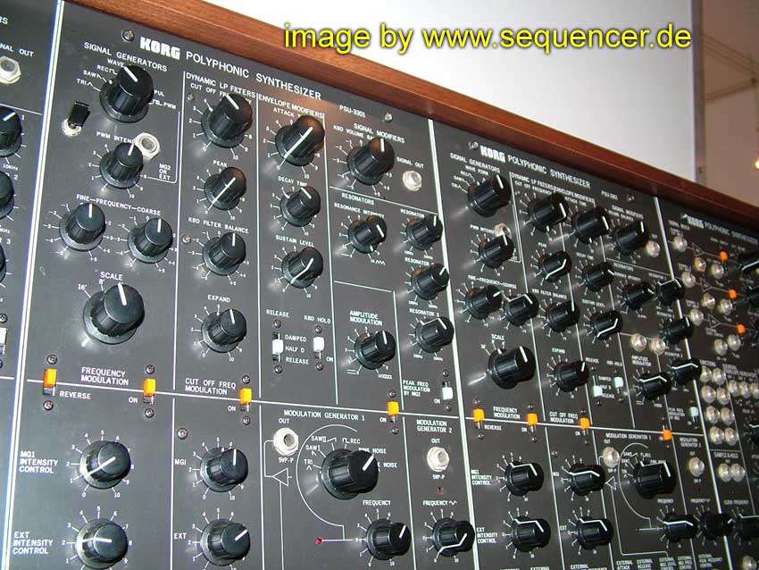

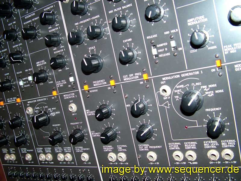

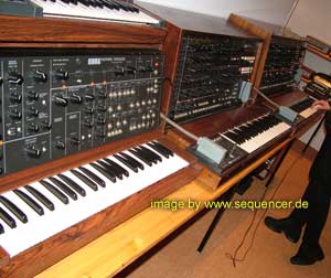

korg PS3100 full polyphonic synthesizer
korg ps3100 synthesizer
(and a small micropreset on top)
the ps series..
KORG

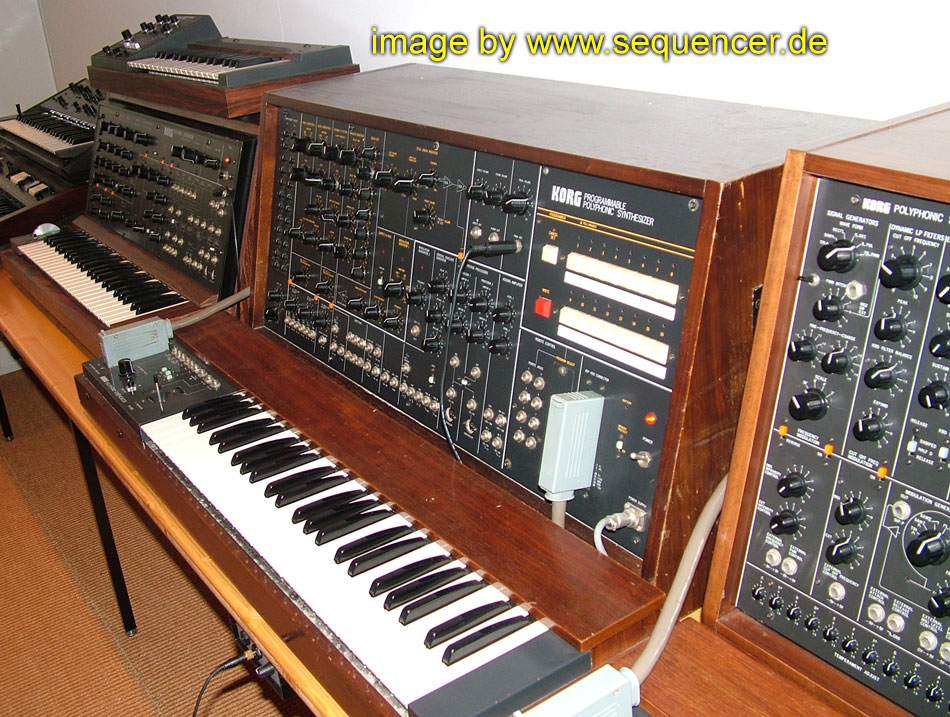

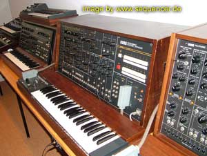

PS3200 - incl 16 memory buttons
korg ps3200
korg ps series ps3200
the

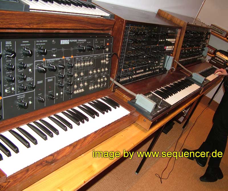

PS3300 consists of 3 complete PS3100s !
korg ps3300
look at the waveforms of the (very fast) lfo..
korg ps3300 mg (lfo)
korg ps3300 panel
