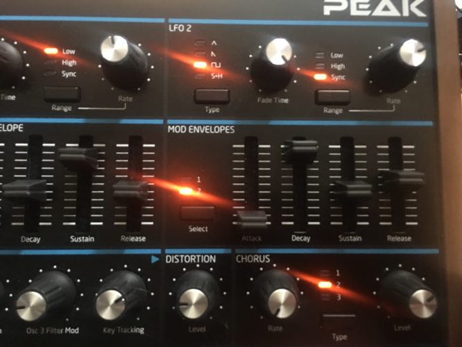

2 very fast audio speed LFOs – 3 ADSR-Envs – with repeat 1-infinite.

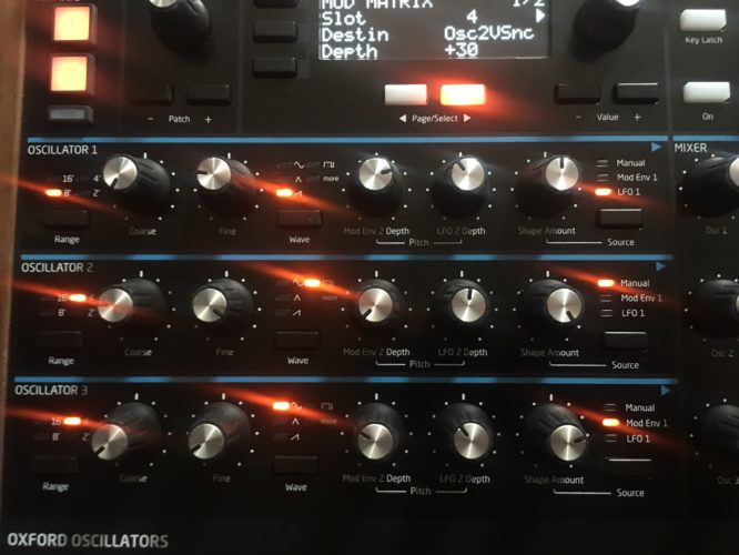

Hybrid – 3 OSCs – Wavetables – Analog Filter (Bass Station 2)
FM , Filter FM, OSC FM 1->2, 2->3, 3->1, Noise FM
Sync per OSC (=> Nova Series)!

16x Mod Matrix
Animation x2 – for fast mod changes like LFO double freq. (wobbles) etc.
2 inputs per Matrix Slot
