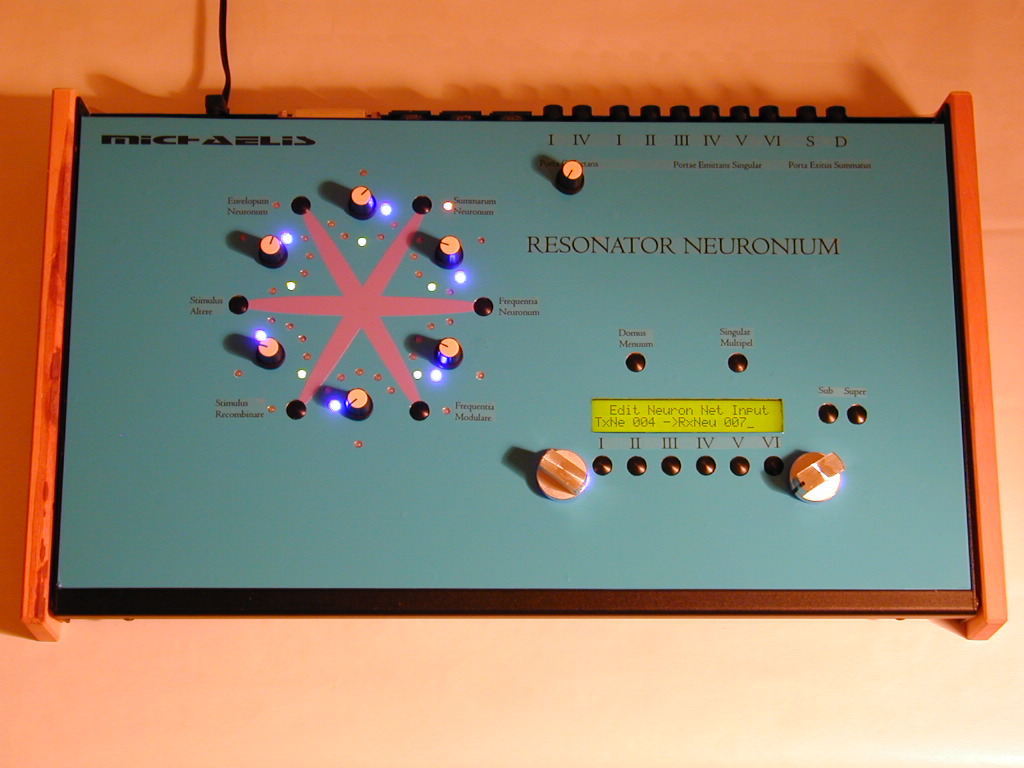

NEURONIUM RESONATOR experimental neuron system more on NEURONIUM..neuronium resonator
jayemsonic resonator neuronium
  • DO NOT CONFUSE THE HARTMANN NEURON and the
NEURONIUM RESONATOR (new design shown on musikmesse 2005)!
1) the neuronium resonator is a hybrid system that works with resonating filters, FM, DSPs and lots of physics that I will not describe all here ;)
its basic idea is to combine both and let the system filter-amp etc oscillate.. (easy sppoken.. its by far more than this). so it creates multiple resonant peaks.. Jürgen will do some more sounds when he has moved (february) and he promised to me to bring it to the musikmesse in Frankfurt.. and make some more sounds after he has moved (right now!)..
this thing will NOT be cheap and is imo worth a look, its another philosophy of how synths might work.. this is NOT a hoax!! (not a sage-synth ;)) haha)

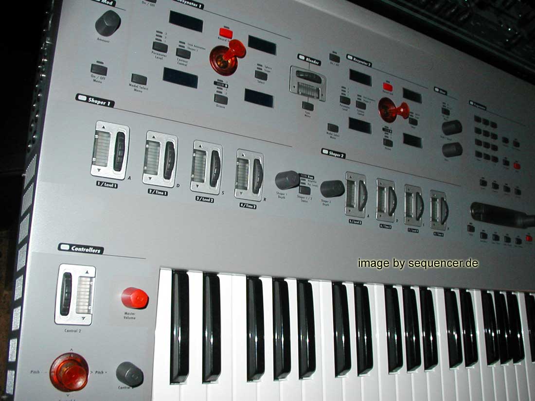

hartmann neuron synthesizer
click to enlarge – pic thanks to plasmatron
the neuron is a sample/resynthesis unit.. seems something like sonicworx in realtime.. imaging some sort of morphing samples!!.. find more in the pdf on my site and better: on marks midiwall.com !! duzzn’t matter ;)

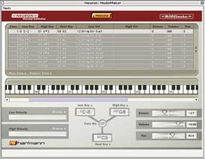

model maker (the software)
model maker
is for assigning samples and choosing a model/complexity level and to transfer the result (the analysed „sample“) to the neuron via ftp (via ethernet!). the model is,what makes the neuron later deside what models will be used and what parameters are available..
like more glassy,metallic, alienize,liquidize, smaller,larger etc.. mac and later pc also (but need to use an ftp client then!

die oberfläche des model maker…sieht aus wie ein sample-editor. beim erstellen der models, ordnest du die jeweiligen samples den jeweiligen tasten-zonen zu:
PROCESS führt dann an ein dialogfenster mit complexity-parameter der samples (nun der name spricht für sich?)
und das gewünschte parametersetup (10 untersch.Typen), das neuron dann verwenden soll.
dann muss alles per ftp vom mac oder pc in den neuron geladen werden (wohl auch mit hinblick auf den musiker ,den man dann direkt vom netz versorgen könnte), pc user brauchen zum modelmaker einen ftp client,was beim mac schon so geht.

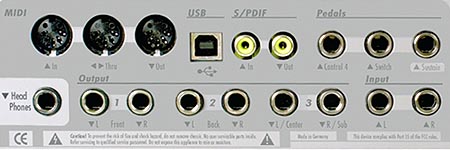

dass die anschlüsse alle links sind ist ein wenig ungewöhnlich.. aber dieser synthesizer ist sowieso ungewöhnlich ;)
