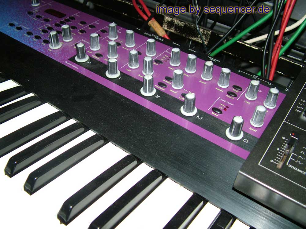

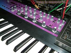

Ensoniq FIZMO Synthesizer
ensoniq fizmo
ensoniq fizmo synthesizer
click this image to enlarge the FIZMO transwave synth
