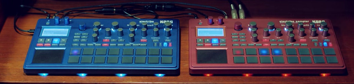

The Electribes got a blue/red colour scheme and a new OS 2.02.
the OS was highly appreciated but it may not be what the Petition wanted Korg to do. it has been updated as well. So it may not be obsolete – but very very important things have been done:
