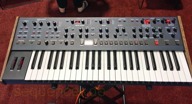

Dave Smith – it’s an Oberheim – the OB6 – the OberDave 6! Polysynth
UPDATE: OB6
es ist ein Oberheim OB6, den DSI vorstellt!
it’s an Oberheim by Dave. And there will be a Rack/Desktop-Version
Audio (src: Bonedo) OB_6_01.mp3
DSI baut tatsächlich den OB6 mit SEM Filter (inkl Morphing von LPF nach HPF) und BPF Modus, sonst ist er weitgehend so ausgestattet wie der Prophet 6, allerdings hat der die Modulations-Abteilung typisch wie bei Oberheims klassischen polyphonen Synths. Und er beherrscht Crossmodulation!
2999€ – ready in 1 month. (march/april)
it’s an Oberheim from Dave Smith!

Dave Smith Instruments today announced the OB-6
- new 6-voice synthesizer
- with all-analog signal path and discrete VCOs and filters d
- developed in collaboration with Tom Oberheim.
- sound engine inspired by Oberheim’s original SEM (core of his acclaimed 4-voice and 8-voice synthesizers
– flanger / phase shifter, ringmodulator – says dave in the video.
“Tom and I have been friends and friendly competitors since the late 1970’s. Back in the day, people were typically in either the Prophet or the Oberheim camp. Now, with the Prophet-6 out and doing so well, we thought it would be fun to combine our strengths and bring back Tom’s classic polyphonic sound, too — in a modern format.” Added Oberheim: “A lot of people, myself included, have always felt that the SEMs had a certain uniquely big, organic sound unlike anything else. Working with Dave to make that sound widely available again with some modern touches and full programmability has been real a pleasure.”
- 2 discrete voltage-controlled oscillators (plus sub-oscillator) per voice,
– continuously variable waveshapes (sawtooth / variable-width pulse, triangle on oscillator 2.
- SEM-inspired state-variable filter (low-pass, high-pass, band-pass, and notch)
- analog VCAs
. “The classic, bold SEM sound is all there,” said Oberheim. - X-Mod, -> filter envelope and oscillator 2 as modulation sources (with bi-polar control). Destinations include oscillator 1 frequency, oscillator 1 shape, oscillator 1 pulse width, filter cutoff, and filter mode.
- dual effects section : reverbs, delays / BBD, chorus, and faithful recreations of Tom Oberheim’s acclaimed phase shifter and ring modulator. 24-bit, 48 kHz
- multimode arpeggiator
- polyphonic step sequencer 64 steps (6 notes per step) plus rests. realtime input
- full-size, four-octave, velocity & aftertouch sensitive.
1st quick audio demos
“As with the Prophet-6, we made size a primary concern on the OB-6. It’s the right mix of power and portability and it fits right in on-stage or in the studio.” Added Oberheim, “And of course, it’s got that unmistakable SEM sound that’s going to turn a lot of heads. ”
