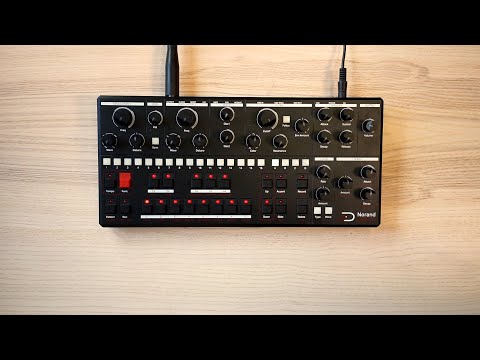

we will meet the people of Norand & a new synth Norand Mono with 2 OSCs, morphable Waveforms and Crossmodulation with Sequencer on tuesday the 3rd. of November. There are a lot of modulation sources, 20 + 8 – so it is a lot more than just what it might look like.
Dean Freud and Moogulator will get you through and you can ask anything at 20:30 for 1-2hrs and re-view it later as often as you like. We will ask and explain anything from and with this new French company Norand coming from NOR and AND (digital functions)
capture and save this: 3rd.Nov.2020 – 20:30 Berlin Time (MID.EUROPEAN WINTER TIME)
note the new Link to our new episodes is now https://www.youtube.com/sequencertalk– subscribe if you like to watch more.
No Rant about Norand?
a little look – but it can do much more than Acid since it has 2 oscs, FM, etc. >> Norand
2 OSC Morph Sine-SQ,TRI,SAW
Thru-zero FM – Xmod / FM
Sync
Detune Sweep, Quant?
3Pol Filter LP-HP-BP „Color“
Filter FM
- 13x AD envelopes
- 20x modulator(S)?
40 mods /Project = 40 motion rec / Project?
666€ pro order, later 850€
Resonanz Bass/Level-Kompensation? ja/ yes
Demos „a World of Modulations“
Seq 64 Step, Roll/Ratchet per Step inkl Parameter-Locks
2048 Patterns
Random
lfos = 10kHz!
„no / keine 303“
Motion Record wie viele? löschen einzelner Automations?
AFX Mode 40 Timbres umschaltbar – like the BS2 AFX Mode!
„a ton of creative features“
1024x Undo!
32 projects x 64 patches
Accents = full vel? or sound changes?
Propbability, Ratchet, Microtiming-Shifts
