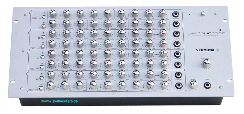

vermona per4mer synthesizer
per "channel" you got a tune with 13 semitones range (thats why the waveform switch needs no further octaves.. noise is there,too..
it's controllable via midi or CV/gate (!!!). note: having 4 glides at use at the same time.
VCF: this is a cascading filter but it's not a moog, it's just the cascaded structure ;) it's the interesting filters of the old vermona synth (at the time,where vermona was in the eastern part of germany.. see/hear the filters of the old vermona cult synthesizer!!)
you can trigger the VCA by LFO (like roland sh5 or sh101), gate or ADSR..
ENV: is a classical ADSR. no comment ;)
FM: just set one of the 4 synth to fm and it (the whole SYNTH, incl VCF etc and mods!!) modulate the synth, that is below of it's modulator. set the FM amount with those 2 knobs on the reight FM on VCF or VCO (2 knobs!) thats the HAMMER FEATURE IN HERE!!
LFO: goes to 75hz, so this as also some sort of FM ;)
MODES: poly, duo and single assign modes (like monopoly or oberheim 4 voice) you can also combine these modes maybe FM 2 synth and use the 2 left synth as basslines.. no problem ;))
HOW and WHY 4 "simplesizers"? btw: think of this: you got filter inputs (6!) and inserts, so you could make a 2 VCO synth with 2 individual envs for VCF and VCA.. also you could make some nice 4 filter-noise-spektra thats simply more than just 4 mono synth like the tb303.. think modular! that may be the modern way of using this synth!! remember 500hz lfo and FM and the combination of modes and routing.. more to come..

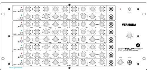

ENLARGE / vergrössern - here you can see ALL PARAMETERS (see the FM??) hier sind alle paramter zu erkennen: click the image to enlarge:

VCO:
Pro Kanal gibt es also den VCO, mit GLIDE, TUNE (+/- 13 Halbtöne) und den Wellenformen
Sägezahn und Rechteck in tiefer und hoher Fußlage, sowie zwei weiteren Puls-Wellenformen
in hoher Fußlage + Noise. Das mit den zwei Pulswellen kommt daher, dass es keine Schalter mit sechs Stellungen gibt und wir nur vier oder acht zur Auswahl hatten, also haben wir das so gelöst.
Mit TUNE und den beiden Fußlagen, deckt man also insgesamt die restlichen Fußlagen mit ab.
Achja, es gibt eine CV-Option, mit der man jeden Kanal mit 1V/Oktave ansteuern kann.
VCF:
Hierbei handelt es sich um ein 24dB Tiefpass, welches allerdings nicht nach Prinzip des DAF bzw.
M.A.R.S. aufgebaut ist, sondern eher ein Kaskadenfilter ist. ich möchte absichtlich nicht Moog-Filter
sagen, weil wir nicht nach dem Prinzip rangegangen sind, dass es wie Moog klingen soll, es ist
halt lediglich das Prinzip das gleiche. (Es ist eigentlich das Filter aus dem alten DDR-VERMONA Synth.)
Das Filter hat den Vorteil, dass es gestimmt bis zu drei Oktaven spielbar ist, was wiederum für FM interessant ist.
VCA:
Es gibt es EG, GATE und ON, welche klar sein dürften, bei LFO wird der VCO vom LFO
moduliert, aber ohne die Möglichkeit eine Intensität einzustellen. Das ist praktisch eher eine
Zugabe, weil wir die Schalterstellung übrig hatten, und weniger als Feature zu bewerten.
ADSR:
Klassische (schnelle) Hüllkurve, die auf den VCA wirkt (wenn dieser auf EG steht); der VCF Regler bestimmt den Anteil der Hüllkurve auf das Filter (positiv und negativ).
LFO:
Wirkt auf VCO und VCF, die beiden ebenso benannten Regler sind für die Intensität zuständig.
Der LFO geht bis 500 Hz (bitte nicht hauen). Aber man kann ja noch mit den VCOs in den hohen Bereich gehen.

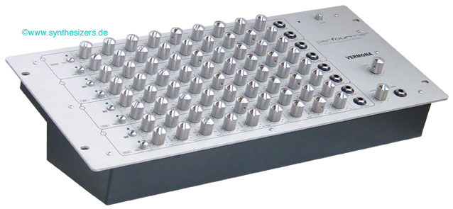

Der Per4mer (oder auch Perfourmer, so seine offizielle Bezeichnung) hat seinen Namen durch ein neues (altes?) Konzept, Vintagefreunde werden sicher eine Verbindung zu Oberheims Four Voice oder auch Korgs Mono/Poly herstellen, wo die Zahl vier ebenfalls eine Rolle spielt. Der VourVoice ist eine Verbindung einfacher aber vollständiger SEM Module über eine Keyboard Assign Technik. Im Mono/Poly bezieht sich dies auf die Oszillatoren, wodurch die Nähe zum Oberheim sicher grösser ist.
Fakten Fakten Fakten..
Das Gerät der Gattung „wohlbeknopft“ hat auf 6 Höheneinheiten 74 silberne Drehregler und 9 Taster zu bieten. Rückwärtig gibt es ähnlich des Microwave XT eine Schräge, die es dem Racker erlaubt nur den 6HE-Rackplatz zu nutzen und dennoch die Anschlüsse einfach und ohne quetschen zugänglich zu lassen. Man findet Midi in und thru. Stereo Ausgang und zwei externe Filtereingänge. Sie befinden sich sozusagen „auf halber Treppe“.
Das Aussenministerium
Die Anzahl der Knöpfe ist hoch für die 6 Höheneinheiten, jedoch nicht so dicht wie dies beim M.a.r.s. Programmer war. Dennoch besteht eine hohe dichte der Knöpfe. Wer lieber ein grösseres Pultgehäuse (das Gerät ist in Pultform nutzbar, auch als Rack verwendbar) hätte, der mag auch weitere Höheneinheiten dafür genutzt wissen. Da ist dieser Kompromiss sicher die bessere Lösung. Rechts und links passen die fettesten Wurstfinger noch durch. Unter und Oberhalb der Regler ist dies eher der kleine Finger. Man mag selber Urteilen. So hat man einiges an Knopfwerk auf engem Raum und kann es auch auf die Bühne stellen. Weniger Bedienelemente hätten „einen der 4 Synthesizer“ gekostet oder gar einige Funktionen. Wer das Drummodul aus gleichem Hause kennt, kommt sicher auch mit dem Perfourmer gut zurecht. Platzmässig sind hier zwar keine Minimoog-Verhältnisse, aber man kann damit gut leben.
Was ist ein Quad Synthesizer?
Der Per4mer ist vier Synthesizer, nicht nur mit mit FM und MIDI miteinander verbunden. Also schon eher nach der Devise „ich bin 4 Öltanks“.
Grundlage ist ein Synthesizer mit einem VCO.. Momeeeeent, ein VCO? Natürlich gibt es 4 VCOs aber dazu mehr weiter unten.
Jetzt aber langsam und klar. Es gibt 4 Synthesizer, welche sich verkoppeln lassen, einer davon besteht aus:
