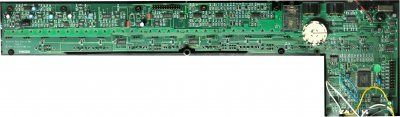

Habe noch Fotos vom PCB gemacht und die mal zusammengefügt (siehe Dateianhang).
Handelt sich hier um die Keyboardversion 1994 MK2.
Filter ist umschaltbar von 12 auf 24 dB.
Etwas links von der Mitte oben gibt es nochmal eine zweireihige 24polige Stiftleist,die mit CON1 bezeichnet ist.
Im Netz habe ich eine Seite gufunden wo über diese Verbindung einige Mods an der Bass Station vorgenommen wurden.
Keine Ahnung, ob diese Verbindung nur zu Servicezwecken vorhanden ist, oder ob das gleiche PCB auch in der Rackversion
Verwendung fand und über die Schnittstelle die erweiterte Funktion realisiert wurde.
Diese Vermutung stellt der Autor der Seite jedenfalls in den Raum.
Dort steht folgendes:
BASS STATION MODS
This page describes some very easy mods that can be found in the Novation Bass Station Keyboard.
My Bass Station (bought used) has always had OSC1 not working, not a big deal as it still sounds great,
but it would be greater if it worked. So i opened it up. On the PCB, there is a 24 pin IDE connector which
is not connected to anything. Going through this with a probe and an oscilloscope, I found a number of the
pins are outputs of different functions of the circuit.
Many of them I didn't spend the time to work out their functions, possibly some of them are inputs as later
Bass Stations had CV/gate inputs and outputs. I chose the following pins to bring to jacks and added some
simple circuits to either buffer, invert or add gain to the signals.
pin 6 - I think this is ENV2, it is just a 0-2V signal so I ran it through 2X gain.
pin 8 - This is an audio signal that seems to be the VCF output modulated by the LFO, it is brutal and sounds
much better than the regular output. The pitch is controlled by the keyboard but it does not pass through a VCA
so it is always on.
pin 10 - I think this is ENV1. It needed to be inverted as it sits on 5V when 'off'. It is a good 5V ADSR signal.
pin 24 - LFO 0-5V signal
pin 22 - This is the unfiltered output from Osc2 but must be post waveshaping as it does PWM and Tri.
Pin 21 - This is also Osc2 but squarewave only, good for sync duty.
Presumably Osc1 outputs should be there too but as it doesn't work, I couldn't find it. Maybe another day.
Hier der Link zur Seite. Dort gibt es auch noch einige Fotos und eine Zeichnung zur Belegung der Schnittstelle.
http://www.sdiy.org/pinky/BStn/BStn.html

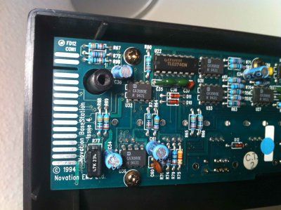

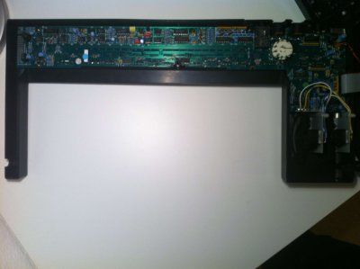

Das ist ja interessant, meine sieht anders aus, die hat noch so eine Art Serviceschnittstelle ganz links, werd gleich mal die Bilder raussuchen.
Nur mal so zur Information: Meine ist eine "Issue 4" und sieht komplett anders aus.
Was ich auch überhaupt nicht verstehe, warum Issue. 2 fast nur SMD ist, und meine Issue. 4 fast keinen SMD-Baustein mehr hat. Macht irgendwie keinen Sinn. Kann das jemand erklären? Oder gehen die Versionsnummern rückwärts ?:) Wahrscheinlich wurde irgendwann auf SMD umgestellt, daher SM.
@Towel: Welche Seriennummer hast du? Meine liegt irgendwo in den 4000, hab das Gerät grade nicht da...
Issue 4 Seriennummer 3594 mit Links Interface Anschluss und kein SMD :dunno: !?

Meine Serien# ist 5388 (issue 2/1994). Ist irgendwie nicht ganz nachvollziehbar das Ganze.
Mich würde ja mal interessieren wie die PCBs der Rackversion aussehen.
...mich würde ja mal sehr interessieren ob es irgendwelche Klangunterschiede zwischen "alt" und "smd" gibt!
Hat euer Velocity-Regler auch trotz "negativer Skala" bei "0" einen harten Anschlag, meiner geht nur in positive Richtung, bei "0" ist stop, in negative Richtung geht nix!?
Eventuelle Unterschiede liegen ja in unterschiedlichen Schaltungen, ob die nun in SMS oder bedrahtet ausgeführt sind, ist nur für Audioesoteriker wichtig. (Bei denen klingen dicke Teile immer besser... )
So nach äußerem Anschein sehen die SMD und die bedrahtete Schaltung gleich aus, im Detail sieht man das natürlich nicht, allerdings kann einem auch bei sehr gleich aussehenden Platinen entgehen, das z.B. R54 von 4k7 auf 47k geändert wurde.
