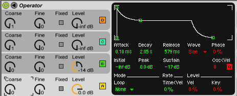

to get it into a percussive shape you need to adjust the envelopes. since you are now using 2 Oscillators note that Oscillator A is the fundamental volume of the overall sound and the modulating oscillator B changes the timbre/sound colour!
the envelopes change the volume of each Oscillator over time, so if you want this to happen for the volume click somewhere on the grey area of oscillator A and it will turn brighter and here you can see controls for Oscillator A volume: the envelope changes the volume over time. The decay time should be short, the sustain level should be smaller after the decay time has passed. You can experiment with the modulating envelope to change the sound dynamically: the graphical interface will give you an idea, what shape the volume will follow. play on the keyboards low notes and move the little green handles and hear what's happening. note that Attack, Decay and Release are all setting durations and the levels are Initial, Peak and Sustain. to hear the effect of Decay you need to lower the Sustain level.
Here is an example how it could be, lets set it like this - if you make the decay longer, it will take too much time to fall back to the Sustain level: Operator FM Bass patch Ableton live The envelope of Oscillator B can chance the sound timbre , so keep the volume envelope "longer" (raise "Decay") to hear the effect, again click on the Oscillator B (shown in light grey here) and you can change it's "way" over time also play around with it like on the volume envelope above. since this is the key of changing the sound itself think of the envelope as a contour shaper. You can set the time it needs to reach the maximum peak level (Attack) and hear the changing timbre. In fact it still modulated the Oscillators Level, but since it is the one that also modulates the frequency of Oscillator B it will change the timbre related to the Coards frequency ratio between both oscillators! So forming the sound happening HERE and this envelope will be the movement of the timbre over time.

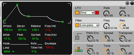

Now it's time to use the Filter to remove some frequencies and overtones that do not sound much like a synth bass now: Switch it on (click the box on the right under the word "Filter" on and set it's envelope and experiment after setting the red Envelope Amount Parameter to 80 or more and the (red) Freq/Vel Parameter for influence of velocity on the filter. the "plucked string" Oscillator C should be set back to 3 now, we want it less accoustic, right?
It should look like this exept the Resonance (ignore tone and time setting!)
Operator FM Bass patch Ableton live The more resonance, the more "electronic" it will sound. The envelopes on the left should always be longer (decay!) than the filter envelope since the filter reduces the overtones above the cutoff frequency. Resonance will amplifiy everything around the cutoff frequency! thats the one you control with the envelope and the more resonance you add the more "unreal" it will sound Try different settings of cutoff and resonance and chance the envelope shape, eg. you could add some attack which is the time from "initial" level to maximum (peak)..
Now it's time to get the maximum of the synth engine and liven up the sound once more, for this experiment simply turn down the Resonance a bit and click on LFO above the filter. it can be seen as another Oscillator, set it's rate to 6.60 and "Mod" (amount of Modulation) up to around 14%. Set the destinations to some of the 3 carrier oscillators, choose A and C (they are inverted when active) like this:
