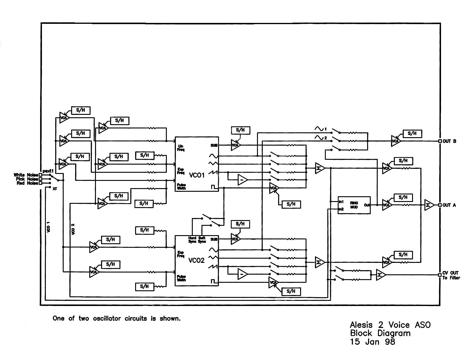

OSC Features lin + exp FM hard+soft sync ring filterFM
Wave Shapes pulse saw triangle sine noise white pink red
2 OSCs + 2 SubOSCs info © sequencer.de

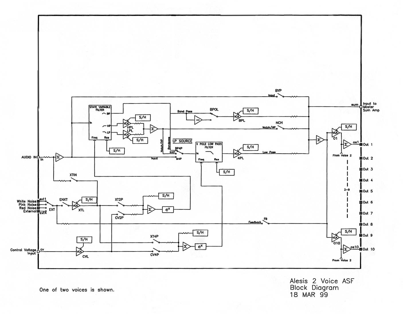

2 Filter lpf hpf bpf notch self reso 2-4 Pole
3 LFOs pulse sym triangle saw random noise
3 Envelope Generators ADLDSRR loop

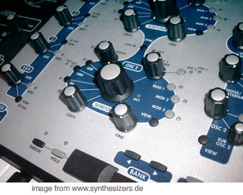

VCOs role models
WHAT ARE THE OSCS and FILTERS A6 VCOs are modeled after the Moog 921 VCO and the 24dB VCFs are modeled after the Moog 904A VCF. Minimoog VCF is slightly different from 904A BTW; feedback path (read: resonance) is slightly different circuitwise. Sonic wise they're the closest, 904A sounds more "open" especially at high resonance. Of course the SEM are still modeled after the SEM filters ,haha ;))
a6 VCOs are..
vorbilder der vcos sind die moog 921er VCOs aus dem moog modular
a6 VCOs are.. VCOs role models synthesizer TEXT

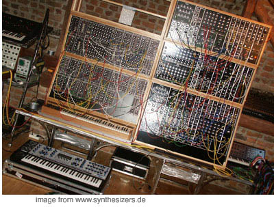

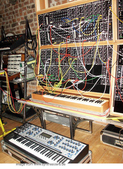

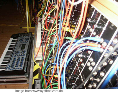

compared Andromeda + moog
I HAD A NICE CHANCE TO COMPARE THE TWO "MONSTERs":
andromeda vs. moog
I compared the VCOS: the andromeda also has the 921's but the moogs seemed to be more broad / fat /.. maybe it compares like the wave to microwave.. it's nearly the same thing on the filters, the same character but the strength of the moogs is somewhat bigger.. still the andromeda sounds authentic moogish but there is a bit of difference in hi-end quality and very high-end quality ;)
the andros aberheim filters are also like this: the chracteristics are very much the SEM and a bit xpander style..
it always comes close to all typical sounds, more than that - it IS the same.. but a moog modular has more pressure behind the sound in overall conclusion
andromeda vs. moog
the VCFs (904) are also the same: the andro sounds GREAT, but the moog still is the only one that sounds a bit "more" into all of those things like broadness, "fatness", brilliance..
andromeda vs. moog
I'd say it's not the difference between a VA and a real analogue.. it's more close .. it's more like twins! they are the same, but still a little difference .. say same family and no doubt about the sound.. it's a moog! btw: the sem also sounds very authentic.. seems the same situation.. no andro user should regret to buy it!!.. ;)) the nicest portable moog ever made.. the only 2 things that are a bit better are voyager and moog modular.
both: andromeda and modular users will not regret to still have it..
sounds to compare yourself will follow end september here!
A6 vs. Moog Modular compared Andromeda + moog synthesizer
A6 vs. Moog Modular
vergleich moog - andromeda
A6 vs. Moog Modular compared Andromeda + moog synthesizer IMAGE
A6 vs. Moog Modular
A6 vs. Moog Modular

Andromeda Filter Structure
A6 Andromeda Andromeda A6 synthesizer
A6 Andromeda
die Filterstruktur des Andromeda
A6 Andromeda Andromeda A6 synthesizer IMAGE

Andromeda Oscillator Structure
A6 Andromeda
die Oszillator-Struktur des Andromeda

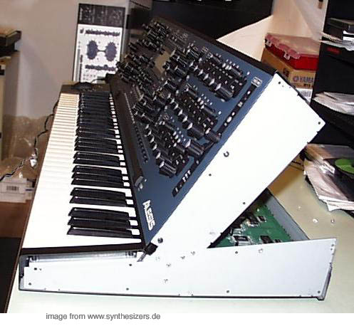

kris rhens aurora mod
kris rhens mod of the andromeda - the aurora mod
WARRANTY VOID ANDRO-ID! - AURORA project
want it without warranty? ask kris rhen, who did aurora!:
this one is stolen from/more pix here: Aurora better check this now - "aurora" got an own website: aurora/
now incl. wooden side panels and more mods..
andromeda aurora modification
here's the aurora by kris rhen again, pic is also by krhen of course (both!!)
aurora andromeda a6
update: seems Kris removed the nice pics..
Aurora Mod kris rhens aurora mod synthesizer
Aurora Mod
kris rhens aurora mod - klick auf das bild..
Aurora Mod kris rhens aurora mod synthesizer IMAGE
