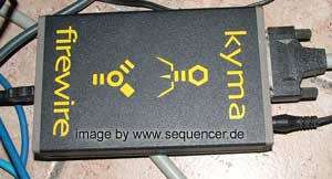

the interface connects kyma to the mac via firewire..
works with os x tiger but also with os 9 etc..
